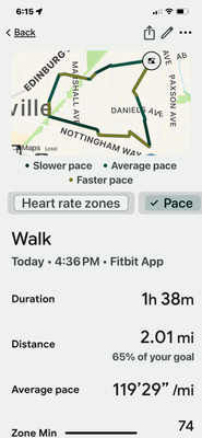

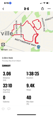

Well I updated the app to the most recent version, did everything you suggested in your post, and the app worked correctly…….for one day. Now it’s not working properly again. I am attaching photos of what it should look like, (I use multiple app to track my activity since the Fitbit app hasn’t been working for months now.) and what the Fitbit app shows. The actual walk was just over 3 miles, but Fitbit shows it being just over 2. I really wish Fitbit would fix the problem.
my route being.

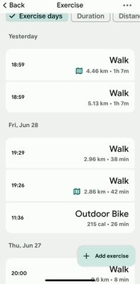

Mine has been pretty consistent now. Map does not deviate. Maybe it was app updates and iOS updates that fixed it. The only issue I have now is that I start activity on my Fitbit app on phone and also on my watch. The 2 do not have the same distance at the end.
same steps sometimes but distance is always different. See attached screenshot the Fitbit app is always the lower in distance.
