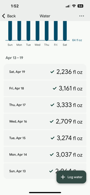

My Inspire 3 has suddenly started incorrectly reporting my water data. It’s changed all of my old data to new much higher amounts. Yesterday I logged around 48 fl oz. Now it reads 1065 fl oz logged! And all previous days are logged as extremely high too. Is there some software glitch going on? Any ideas on fixing this issue? I’ve closed and reopened the app, but that did nothing. I tried reaching out to customer service chat, but they’re “currently unavailable”.

Best AnswerI've upgraded to the 4.43 app version. My water data from April 2 until May 21 still reads in the 1000s of oz, but the data before and after that range are correct.
My data is incorrect Apr 1 - May 18.
The historical data that was converted from OZ to ML when 4.39 updated (3/31) was corrected with 4.43. When the historical was corrected it also changed the then current data (4/1 - 5/18), assuming all entries were in ML even though entries after April 1 were correct in OZ.
