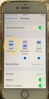

No, @Tblanch - Fitbit cannot control what shows up on your phone. But, you can change your phone settings so that your messages will not appear on your locked screen. To do this:
This should do it. You may want to close the Fitbit app completely, then power the phone off ... wait a couple minutes ... then power back on. This will get everything in sync.

After trying literally everything FitBit recommended this actually worked for me. Changing the Show Previews Setting to either Always or When Unlocked allowed me to get text messages back on my FitBit Versa, but when I switched back to Never my FitBit stopped receiving texts again.
It is strange because my settings were always set to Never for Show Previews and text messages worked fine until iOS 13. HEY FITBIT FIGURE IT OUT.

I too was someone that experienced everything working fine (receiving all my texts and other notifications) from my charge 3 to my iPhone until I did the iOS 13 update. After the iOS 13 update my texts would not come through no matter what I did-Facebook, Instagram, those still worked-it was only my text messages that were not getting sent to my Charge 3. I tried all the recommended steps above and still no luck.
Tonight I FINALLY got my texts to work again; though I'm not entirely sure what I did to make it work, here are the things I did to that resulted in receiving text notifications again to my Charge 3 from my iPhone 8:
I hope this helps!

Did you check this setting in your messages app vs the Fitbit app?(Settings>Notifications>Messages>Show Previews) Before when I was given this same advice I was only looking in my Fitbit app notification settings, not my messenger app settings. I've always had my text previews off on my iPhone (I didn't like people reading my texts when they popped up on the screen), and I even had this setting this way when my texts were successfully sending to my charge 3 before I updated to iOS13, but I assume that has changed. As recommended above, in the messages app where it says, Options>Show Previews, I had selected "never" and changed it to "when unlocked" in (my Messages app). Even after doing this however, it did not work until I rebooted and restarted my charge 3. I also hard reset my iPhone. Hope this helps!
If you select "when unlocked" it will show that you have a new text message on your iPhone and who it is from, but will not have the content of that text on your screen. It will also allow the texts to come through to your FB. Hope this helps!
