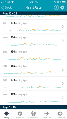

In both the mobile app and the Web Dashboard, the Resting Heart Rate values are displayed in integer values.
In the mobile app the RHR rounded to the nearest integer and plotted as the resultant integer value. Below, the August 18 - 21 values are rounded to 63, 64, 64 and 63 (more on this in the next paragraph).

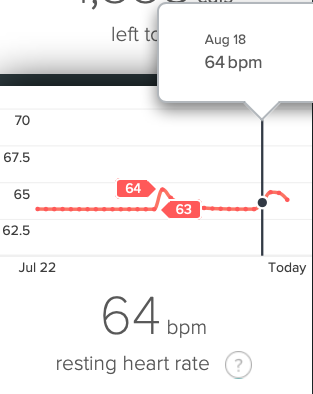

In the Web Dashboard the decimal fraction value is plotted but plotted values are labeled with the integer value -  no rounding up or down. In the graphic below, all of the labels for August 18 - 21 show as 64 bpm when they are clearly not the same plot. Remember, August 18 was 63 in the mobile app.

@JarkaB -
Senior moment on my part.
The web plots the decimal value and then rounds the label to the nearest integer e.g. 4/5 rounding.
The app takes the integer value with no rounding and plots that value as well as labeling with that value.
