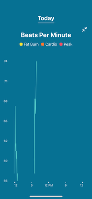

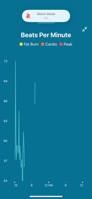

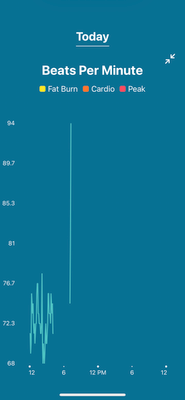

NO, the app update to 4.04 has NOT fixed the missing heart rate and sleep data problem. I had a full night of data 2 nights ago after the update but I’m missing data last night from about 1 to 7am.
Is the device tracking heart rate, but it’s not relayed to the app? See the attached pics. The Versa 4 has a tile with a graph of 2 hours of heart rate data. This shows data from 540 to 740am, but you can see the graph in the app is blank from 1 to 650am. I have similar pics from other days.

@Marlo2go I have noticed the same. There are no gaps in heart rate data on my device, I also have a 2 hour tile display on my sense 2 and have checked this periodically overnight. In the same time period though there have been gaps in the heart rate display on the new App. When it (gap) occurs it’s always somewhere between 2am and 7am. Last night I got a full night of data though and it was accurate. Random.
