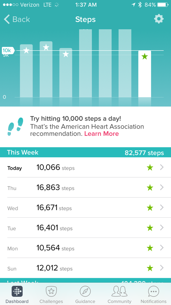

Last night (Thursday) at 10:15ish I went out for a walk with everything showing consistently around 4,900 steps for the day and around 48,000 for the Workweek Hustle in total. I walked steadily for 3 hours at a reasonably consistent pace, and according to IOS App daily totals, logged a little over an additional 12,000 steps before midnight and another 10,000 after midnight. See phone screenshot below.

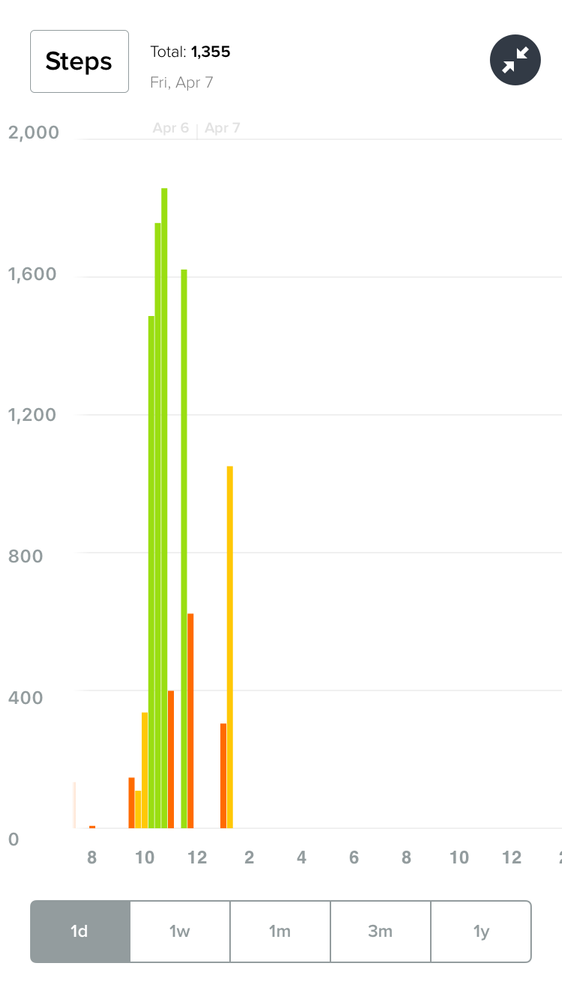

So far so good. But both the Weekwork Hustle and detailed daily totals missed a whole bunch of steps that I know that I took. See the detailed screen below. From where the green bars start a little after 10:00pm they should be fairly consistent from then until around 1:15am. But instead they either show minimal activity or none at all. During a time that I was definitely walking.

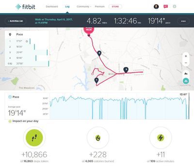

I noticed this when competitors in the challenge were passing me and increasing leads while I stayed the same even while walking. Around 11:45pm I started up the "Walk" exercise with GPS active on my Surge to see if that made any difference. It didn't seem to, but it does provide confirmation that I was up and walking around at that time... which shows in the daily totals but not in the challenge or in the daily detail.
As you can see, I was up walking from 11:41 for 92 minutes and logged 10,800 steps. Almost none of which is reflected in the detailed bar chart above.

And just to be clear, my summary daily step total is consistent from Surge to IOS to Web Dashboard. It is in the daily detail activity database/graphs that steps are not recorded correctly, and this appears to govern what is reported for the challenge.
