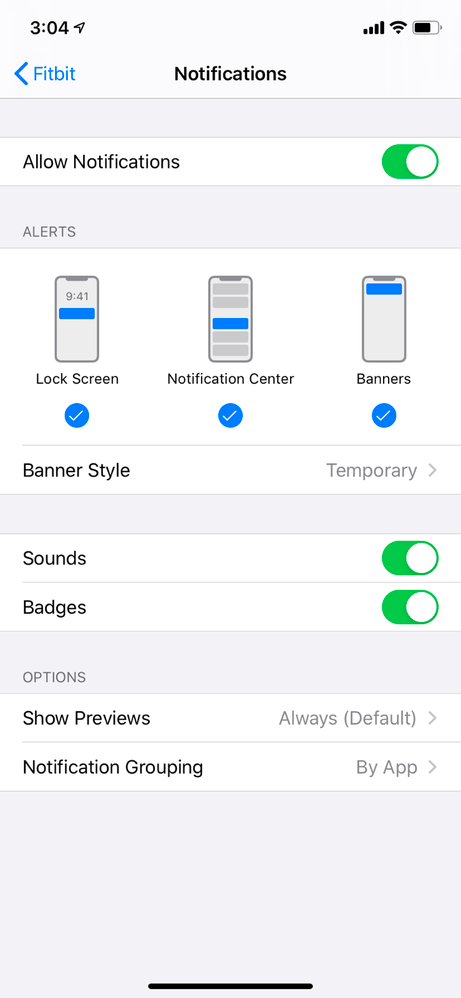

Go to Phone: settings
Notifications
Show Previews
Set to Always
Go to Fitbit app under phone settings, notifications
Allow Notifications
Alerts - Press phone icon - Lock Screen, Notification Center, Banners
Sounds and Badges on
Show Previews Always (Default)
Notification Grouping . By App

Best AnswerShow previews is at the very top of Notifications page under your phone settings
Phone settings
Notification
Show Preview very top of Noftifications
Best AnswerMake sure you have the check marks under the phone icons

Your phone settings affect your fitbit. Do you see fitbit at the top of this picture. To control messages from your phone sent by blue tooth to your fitbit device, settings have to be on.
