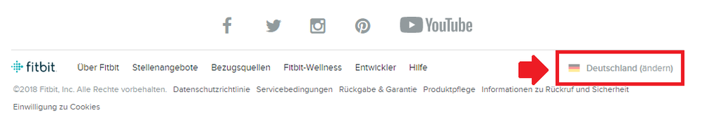

Hello! I just bought new Fitbit charge 2 and when I cnahge the language to English, it just goes back to german. The same happens on the Fitbit website, it s just gives me a java message saying “javascript{0}”. All my settings are set rock great Britten, but it’s still set to german.

Hello @Guilherme_Fitbi, I hope you're doing well, thanks for taking the time to reply.
I appreciate you have tried the troubleshooting steps I've described above. At this moment I would like to suggest you to go to the online Dashboard and scroll all the way down. You will be able to see the country currently set in your account / Dashboard / tracker:
If the country is any other than yours, click on it and you will be redirected to a page where you can change it. Select your country and then sync your tracker.
Now, when it comes to the clock-faces, go to the device Settings inside the online Dashboard and search for Clock Display. Click on it to change your current clock-face. Don't forget to sync afterwards for the changes to take effect.

Hello @Guilherme_Fitbi and @avensis, I hope you're doing well, it's nice to see you around.
@Guilherme_Fitbi, thanks for letting me know you have tried to change your country already. Would it be possible for you to reply to me with a screenshot of what you're able to see when you select a different country? That will be very helpful for me.
