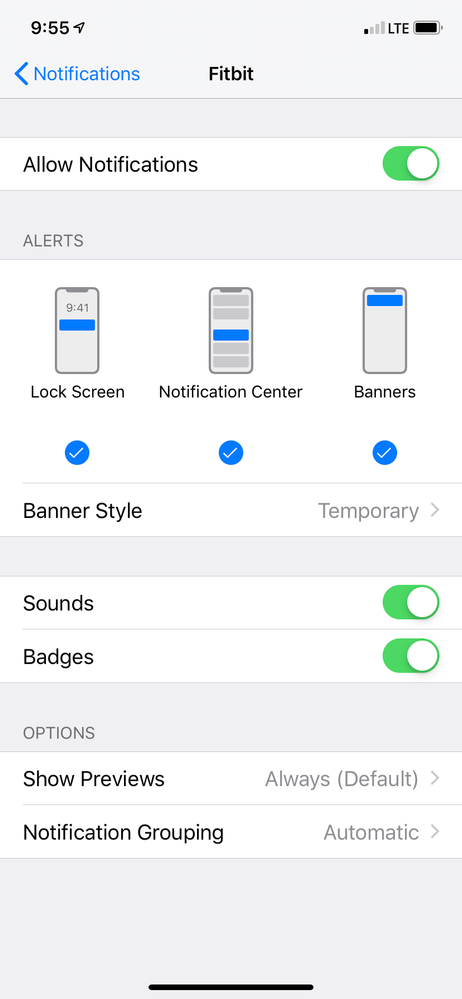

@Neaturejuegirl, I appreciate you have taken the time to report this and thanks for having tried the troubleshooting steps provided earlier. Tell me, are you not receiving a specific kind of Notifications or are you not receiving Notifications at all? Would it be possible for you to go your phone Settings >Notifications > Fitbit / Settings > Notifications > Messages and take a screenshot of what you're able to see here? Then reply to us with these screenshots, they will be very helpful for us to check this further.

Best AnswerHere’s the screenshot you asked for.
Best Answer@MarcoGFitbit I am not receiving any type of notifications besides the hourly step alerts if I haven't gotten 250 steps. The notifications are turned on on my watch and on my phone and in the fitbit app. I've disconnected my watch completely from the fitbit app, forgotten the device on my bluetooth on my phone, and restarted my phone dozens of times... still no notifications.
