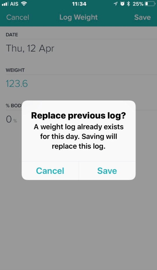

I am having the same problem.
I log my weight every morning , I only log my weight one time per day.
Sometimes , but not every time I get the message Replace Previous Log? Cancel or Save
Of course I choose save , in this instance my log is not saved.
I have to then re-save it.
It really is annoying and makes Fitbit useless to me.

Hello @TheHamburger, I hope you're doing well, it's nice to see you around.
I appreciate you have reported this issue as well. Tell me, how are you logging your weight? Do you log by tapping on the plus (+) sign in the Dashboard or do you tap on the weight tile and then on "Log Weight"? At this moment I would like to gather some more information from you so I can check this further:

I usually use the Taptic menu,
iPhone 7+
iOS 11.3.1
Fitbit 2.50 (760)

Hello @TheHamburger, I hope you're doing well, thanks for taking the time to reply.
I appreciate you have replied with the information and the screenshot requested. At this moment I will forward the information to our team so they can take a better look at this situation that it seems is only affecting the 3D touch functions of the app. In the meantime, please open the Fitbit app and log your weight through the Weight tile inside the Fitbit app.

Selecting Log Weight from the 3D Touch quick action list results in a couple bugs and does not save the entered data.
Environment:
iPhone 6s
iOS 11.3
Fitbit 2.50
steps:
1. At the home screen, 3D Touch the Fitbit icon to open the quick action menu
2. Select Log Weight
3. Enter a weight and select Save
4. An alert is displayed asking if I would like to replace the previous log (this displays even when there are no previous entries)
5. Select Save on the alert
6. The Log Weight view dismisses
7. Navigate to the Weight section
8. Observe the Weight was not saved
Expected:
The weight entry should be saved. The alert should not be displayed at step 4 if there are no other entries for the current day.
