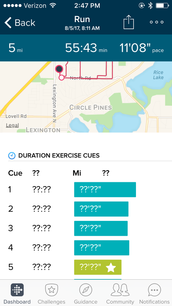

Hey everyone -- Can you share a screenshot of what you're seeing? That'll be super helpful to share with our iOS team to further investigate this. Thanks in advance.
@Carlsim @Lilly_CM @Stephmarlowe Can you share a screenshot of what you're seeing? That'll be super helpful to share with our iOS team to further investigate this. Thanks in advance.
The first two pictures are from the same run, the first picture shows up in the list format, but when I click through the correct map of the run appears.
The last photo is a past run that now has no times listed.

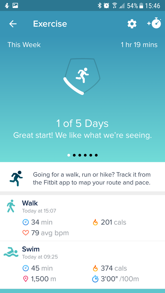

Ok I think the screenshots are attached now!!!
The first picture was taken as soon as I finished my walk, the second picture was about 5 minutes later, the map has disappeared. I can no longer see the distance, pace etc.
As you can see my GPS is working fine.
