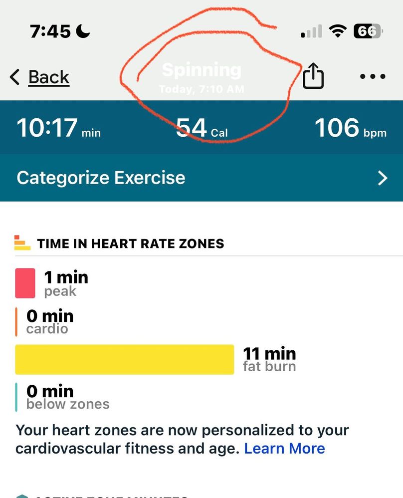

If you could, since I'm not sure where to report other app issues or bugs, perhaps you could forward the following to the appropriate group. I am using an iPhone 13 mini running IOS 16.7, using a Fitbit Versa 2 and am using the Fitbit app v 4.01 which I installed on 4OCT2023. There are still a few bugs that I'd like to report which are:
1) Some of the exercise detail screens use a white font on a light gray background in the header which makes part of the screen header and some controls. See pics below.

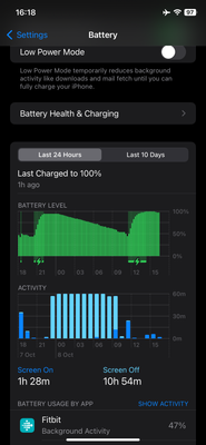

Still draining battery, bizarrely during night time when I am sleeping or during an activity. The charge 5 should track so why is the phone draining?
10-08-2023 08:24
10-08-2023 08:24
Also, background app refresh, location, etc are all turned off. Past 24 hours. 47% battery drain.
The only fix for now is to close the app.

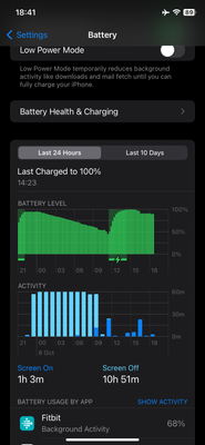

68% battery used. This is not normal. Could the mods report to devs pls?
10-09-2023 05:13
10-09-2023 05:13
Hi @LizzyFitbit The battery drain is still there 68% was used yesterday. Obviously a bug and the app shouldn’t be draining with everything turned off.

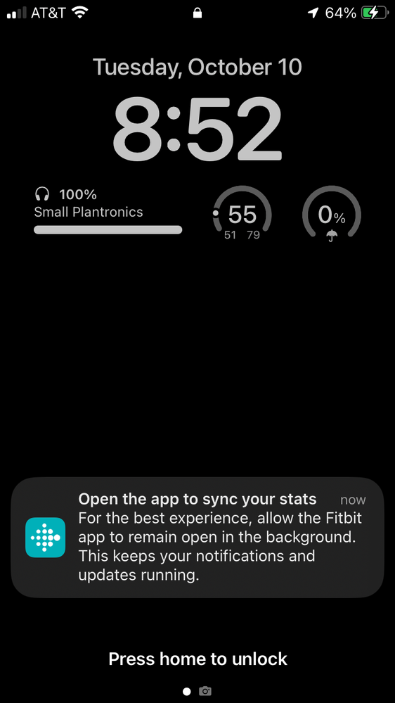

I too am having the same problem, 2020 iPhone SE with 17.0.3. I put on the new app this morning. My phone keeps using up about 60%-70% battery via Fitbit. I have stopped the app today to see how it goes. I love this notification I get after doing so:
