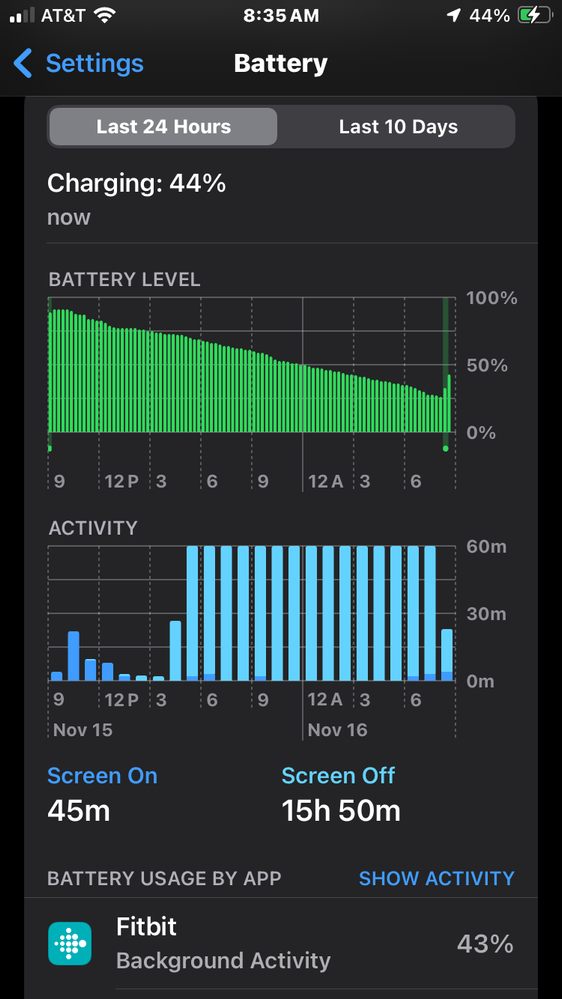

For me, it did the same thing again on this version. From 10pm to 6am you can see the battery depletion over night. You can see when I took the screen capture it's back on the charger. Up until this test, I've been killing the app every time I sync to preserve my battery.

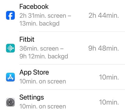

Just downloaded onto my iPhone. Says it was an available 3 days ago but only today for myself and husband. Great to have battery % on iPhone. Hope it fixes the 9 hour drain on my iPhone overnight though 😭

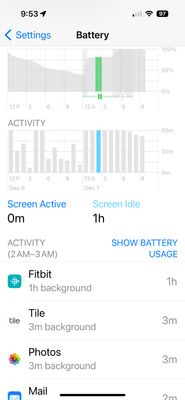

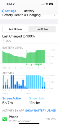

I’m showing exactly the opposite of that from the 4.06 release.
an example:
12-08-2023 06:34
12-08-2023 06:34
the same for me
