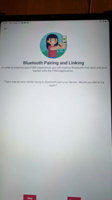

I just bought my kids each an ace 3 as they want to compete with friends and each other. Managed to get the units connected partially and update the time but that is pretty much it. The Bluetooth connection won't allow sync, software updates or watch face changes. Pretty sad, please help Google/Fitbit support!
Adding that I use the OG pixel watch and pixel 8 to add the 2 child accounts and 2 ace 3's. Tried on a tablet with the same parent account and same results.

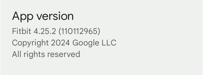

Well, the bug is back.. updated to September 11, 2024 version 4.25.2 and no more syncing with either ace 3! Wow!
That's the version I have. Same issues
