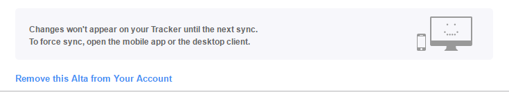

I'd really like to see a factory reset option for if the device needs to be returned to the merchant.
Hey hey hey, welcome to the Forums @theajayieffect and @Gort Robot LOL. Blackberry phone isn't a supported device @theajayieffect, so it won't sync all the time. You can check the supported devices list.
@Gort, currently, there's no a factory reset option and if you remove the device from your account your information won't be longer there:
