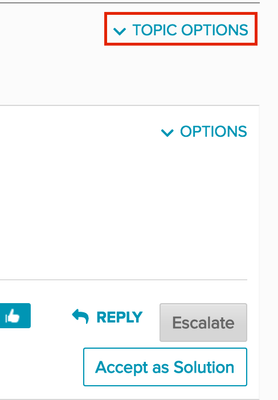

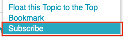

@bettecrockerba You should be able to unsubscribe from these threads from the top "Topic Options" menu.
