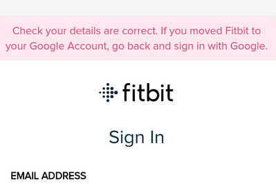

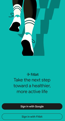

Thanks for pushing Fitbit with your reports proving that the Irregular Rhythm notification is not functioning as it should. Next thing is not what a Customer should do, especially when it is not an isolated case. Anyway.
This reply is based on facts, but anyhow, to be confirmed by fitbit's moderator... I guess.
Once the original Fitbit account is transferred to a Google account, there is no way back (@fitbit: please confirm)
As it is displayed: 'Once moved to Google, sign in with Google'
The attached pictures speak for themselves.
The history of this subject shows that it is not a one or two incidents case, but a severe issue to be solved @fitbit's side with any sense of urgency.
