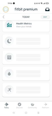

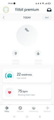

The app looks like this today. Yesterday, it was fine & showed all info. Anyone know what could be wrong? I have restarted, etc but still looks like this.
