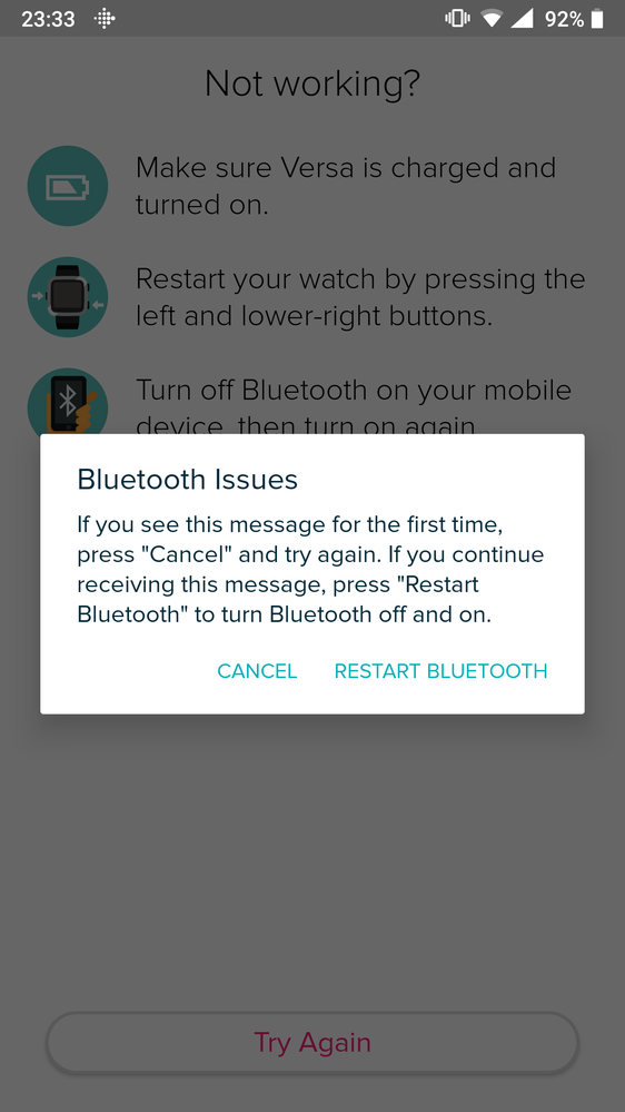

I've been having difficulty as well with both my Charge 2, Charge 3 and my Galaxy S8. I have to log out of the app and hope that it asks me to link to either of them. I keep getting requests to restart Bluetooth. This is ridiculous, it's been Months.

Best AnswerHi @LanuzaFitbit thanks but I'm sorry to say that it didn't last. My Fitbit Versa has stopped syncing as of this morning. I can still sync via Bluetooth or the Fitbit Dongle on my Mac and PC but cannot sync on my phone anymore. It lasted for maybe 6 hours before stopping. All that time my Google Pixel XL 1 and the Fitbit Versa were no more than 10 feet apart. Now my Versa refuses to connect at all to the Pixel XL.
Hopefully, that helps in troubleshooting. I should also bring up that we have a Google Issue Tracker open at: https://issuetracker.google.com/issues/123997469
More people that get onto the tracker and Star the issue and comment the more Google will also look into this on their end as well.
