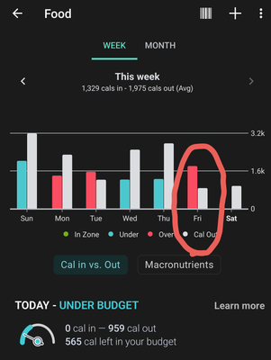

Has this been fixed yet? I am experiencing the same issue. Calorie out in the food section not syncing with calories burned.

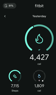

No as of this morning at least two days are off. Here's an example from yesterday.

Hi, @Lem5 & @poppyL, I've replicated your experience & note that if you sign out from your Fitbit app & then log in again, the "Calories Out" bar repopulates. From the "Today" screen, touch your Icon in the top right corner>Fitbit Settings>swipe up to the bottom Sign Out>confirm>Now sign in again with Google on this green screen. Touch the "Food" tile & you should be on track again. Let us know how you get on by posting here again.

Thanks for your suggestion. Signing out and back in worked and all delinquent days corrected themselves.
