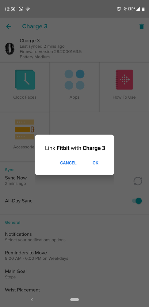

I just noticed that while my Fitbit is connected (when the Fitbit app is open on my phone), the location icon appears on my notification bar.
When I press the home button or switch apps, the location icon disappears and my Fitbit loses connection.
This is obviously an issue with the app on Android pie.
EDIT:
I reverted to the Fitbit app version 3.2 and my GPS works now. Something broke on the 3.3 update.
EDIT 2:
After I hit the ok button on the screenshot below, the problem came back. I uninstalled version 3.2, rebooted my phone, and installed 3.3 again. This time I hit cancel on the popup and my GPS works. I'm still able to sync and everything.
EDIT:
EDIT 2:

@SunsetRunner this seems to work! thank you very much for solution. But that pop up, won't go away, even if i cancel it.

@Bella88 Glad I could help. Support is useless, I haven't heard back from them in over a day now. I had to figure this "fix" out through trial and error.
In my case, the popup only comes up if I open the Fitbit app from the Fitbit Sync Service notification but I just hit cancel again and it goes away.
It looks like the sync service stops running if you hit the ok button and that's why connected GPS only worked while the app was running.
This seems to be a problem on Android 9 because everything works fine on my old phone with Android 8.
