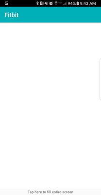

As long as I've been using Fitbit, the app has always been pretty bad. I used to have it on my phone and a while back I deleted it and installed it on my iPad. Now that I have an Ionic, I want the app on my phone so I can get notifications. For me, though, it's been a disaster.
The problem that I'm having is when I start it, half the time or more, I get nothing but a white screen. When I do eventually get the app to open, if I try to go look at a specific device, the list of devices (One, Surge, and Ionic) will show no devices, with my only option being to add a new device. And even when I do get to the Ionic eventually, it often just won't sync.
I have no idea what else I can do. I have a Note 8. I used to have a Samsung Gear 2, but I've since uninstalled all of the Gear software and shut the Gear off to attempt to troubleshoot this issue. Doing that was a complete waste of my time. I have the latest Fitbit app installed on my phone. I've tried uninstalling and installing it a bunch of times, but it has done no good.
I've stuck with Fitbit because I have been collecting statistics on it since the first tracker came out. More and more, I'm starting to regret that and am starting to think that it might be time to just move on to something else. I am thoroughly tired of barely functioning software that is more of a headache than anything else.
Before I give up, though, just wondering if anyone's run into this problem and if there is any way to fix it. I really want to like the Ionic, but with all of these issues, I am finding it a difficult thing to do.

I have tried this workaround a bunch of times, as well as uninstalling and reinstalling the app (pain in the a$$ doing that). I care less about workarounds and more about fixing this. I can understand having to do a workaround once, but this is a frequent problem, along with nothing syncing and not getting notifications on my watch. I really love the ionic, but this software is a terrible mess. Anyway, I've attached the requested images. One shows the white screen that I frequently get. The other one shows that the app seems to think that I have no devices, even though I have a One, a Surge, and an Ionic.
I also have an iPad. As a test, I deleted the app from my Note 8 and installed the iPhone app on the iPad. It ALWAYS syncs quickly and I've never once had a white screen or a list missing devices on it. That app is a hell of a lot better than the Android app. After testing this, I deleted the app from my iPad and reinstalled it (again!) on my phone. If I didn't want notifications on my Ionic, I'd just leave the iPad app alone and remove it from the phone. Of course with the number of notifications that I DON'T get, that might still be worth doing.
White screen of death
