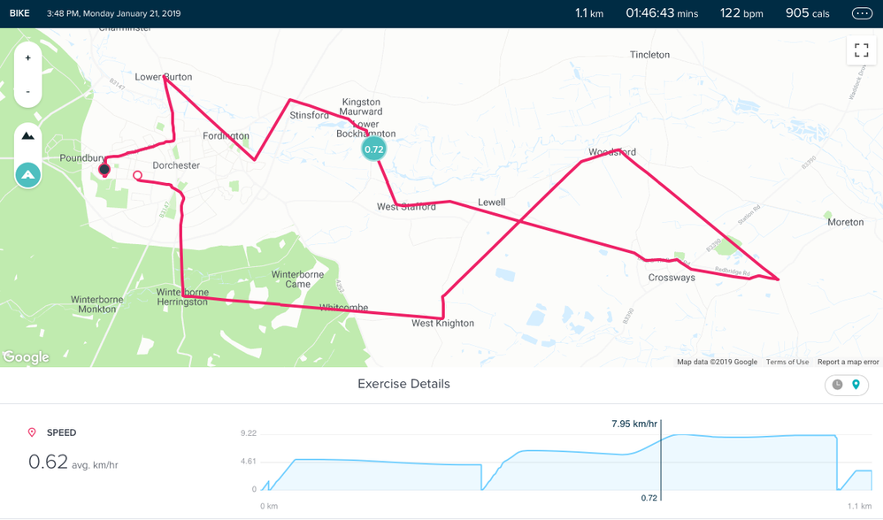

See below some screenshots which highlight some of the issues I have been experiencing:
First screenshot from my FitBit Dashboard activity shows a cycle ride I did. Fitbit has not recorded this activity correctly.
  • Its showing my total distance is 1.1km but the red line shows around 30km
  • Its showing my average speed as .62 km/hr when in fact my average speed was around 27km/hr
  • The spot km/hr indicated shows .72 km/hr when in fact it should be reading around 32km/hr
So whats the problem here?

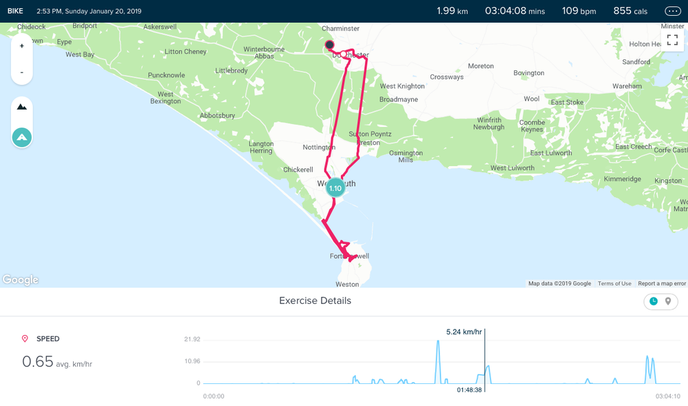

 Here's another screenshot showing another cycle ride with incorrect data (i shall post a screenshot of the same ride but recorded using Strava (in conjunction with Garmin cycle device)
  • Its telling me I've done 1.99km but the actual distance as shown by the red line is around 50km
  • Showing an average of .65kmph but my average would have been around 26kmph.
  • the spot speed indicated on the map reads 1.10kmph but the actually speed would have been around 30kmph
So whats happening here?

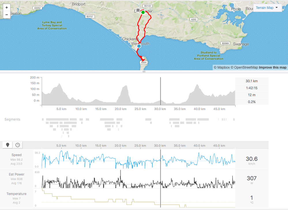

And finally a screen shot of the same ride but a Strava Recording, which is recording correct data.
