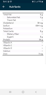

Unclear why they're claiming this was fixed when it clearly isn't. I am on latest Android, fresh install of latest Fitbit app (new phone just yesterday). Tracking sodium, the app shows nutrient summary for the day as 4575mg, which is insane! I double checked all labels at home and confirmed the log entries matched the correct sodium levels for the serving sizes entered. All measurements showing on labels and in log in mg only. When manually adding all sodium, the correct total is 1480mg.
There's a MASSIVE difference between 1480mg and 4575mg. No matter what conversions I run, I cannot come up with "4575". Where is this number coming from? It's clearly not the logged sodium!

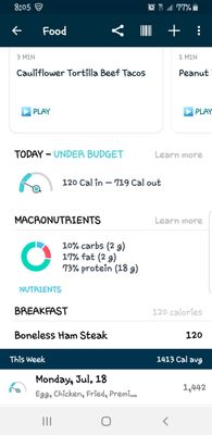

Main screen for foods shows the daily total nutrients correctly. Hit the nutrients button underneath to get detailed information and everything is 2 to 3 times the amount shown on first screen. Why the difference. I would like to have the correct info displayed, not vastly over inflated amounts.

same issue currently exists on the Android app too... only occurs where a food item that is logged is not '1 of something'.... for example if you're adding a food consumed that is down as being declared as a10g serving = the nutrients declared, at the moment, both apps are effectively seeing the macros and sodium content as for a 1g serving, then multiplying that by the serving size you've declared as being consumed - i.e. 10g - so multiplies the 10g serving details by 10..... obviously the figures get more ridiculously exotic if you're logging 250g/ml or 500g/ml!!

for example my protein consumption so far today is 74g , but if i go to the nutrients details it is 4751g which doesnt make sense ofc
it is the same for all others data, so nothing is correct just used the protein one as an example

If you press and hold the columns on the macro nutrient bar graph, the values for protein, fat, and carbs are exactly 2 times higher than the amounts shown under the pie chart.
