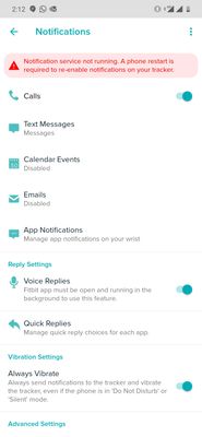

Sometimes mine works fine but when I am unable to receive the notifications.
I get the error attached above. Already rebooted  the device several times. Contacted the fitbit support team as well they suggested that your device is not supported please raise the concern on community.
1) Disable the battery optimization for the Fitbit app
2) Lock Fitbit app in multitasking switcher
3) Restart your OnePlus device
Fitbit Versa 2
Note 10 Aura White | Galaxy Watch 3 Silver | Buds+ White
Great help man its done for now 👍. But if I will get a problem again will definitely let you know on this post.
