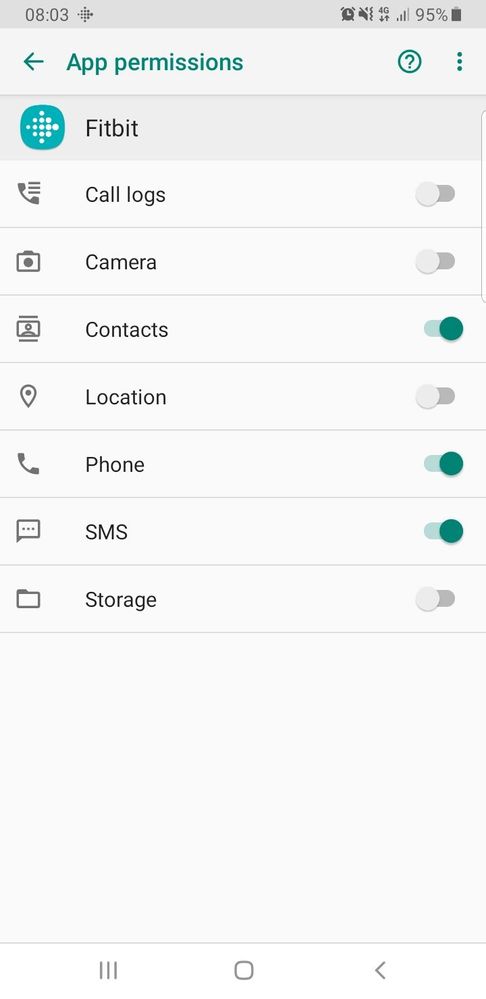

This worked for me Samsung Galaxy S9

I got in contact with Fibit support and they recommended the following:
Depending on your phone the steps might of course vary.
Worked for me. Have not had any issue since the 31st of January and my battery is lasting as long as it should again.

My workaround was to revoke the Location services permission for the Fitbit app.
The only thing is that I cannot use the Connected GPS feature.
