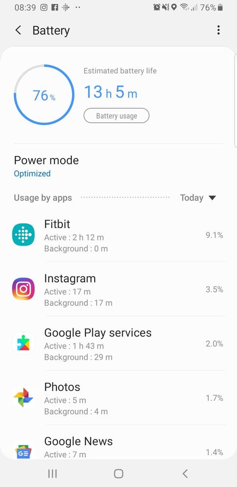

After updating to app version 2.89, the app was behaving for about a week. But, I went for a run this morning -- I purposefully did not press the Run button when my Charge 3 detected I was running.
After the run, I noticed the "Connected GPS is running" notification on my phone, and also that the Fitbit app was using much more battery than it should (see screen shot).
I have a Samsung Galaxy S8 running Android 9 Pie.

@James84 Thanks for providing additional information from what you've experienced. When investigating this issue our developers were no longer able to replicate this problem on version 2.89. I think it is interesting that for you it started with this version. For now, I recommend waiting until 2.90 is released which should be soon and monitoring how it goes from there.
@perspectivus Hey, there! Thanks for following up here on this issue. I recommend uninstalling the Fitbit for Android app and then reinstalling it. Also, give your phone a restart. Some of the issues you may be experiencing otherwise may be due to the Android OS your phone is running. There are known issues with Pie that our team is still working through.
