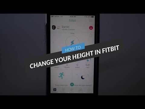

I made YouTube videos to show how to change your height in your Fitbit Profile as well as how to show BMI during a weigh-in. You can view them here:

Follow along as I show you how to change you height in your Fitbit profile. You'll need your actual height to get an accurate value for your BMI if you have a Fitbit Aria or Aria 2. Fitbit Aria 2 ➜ http://geni.us/aria2 (Amazon) ============================== Subscribe to get notified of new videos
I followed the instructions in the "How to Change Height in Fitbit" video, and found out that my Personal page shows my height to be 2'3", but when I tap on that line to change it, it shows my correct height.  Do you know if this will affect my BMI calculation?
Hello @PilSung25 and a warm welcome.  BMI is a simple calculation using height and weight.  By the CDC standards, a normal BMI is 18.8 - 24.9 is normal, 25 - 29.9 is overweight and so on.  If your scale is using the wrong height, then you might get a number around 200.  If you are seeing a typical number, then your scale is using the correct height.
