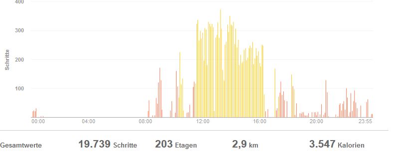

I got mountainbike rides with 15.000+ Steps and over 200 floors!
I send the topic to the Support in June and nothing happens!

The "steps" received from cycling are from the bumps that are being ridden over.
