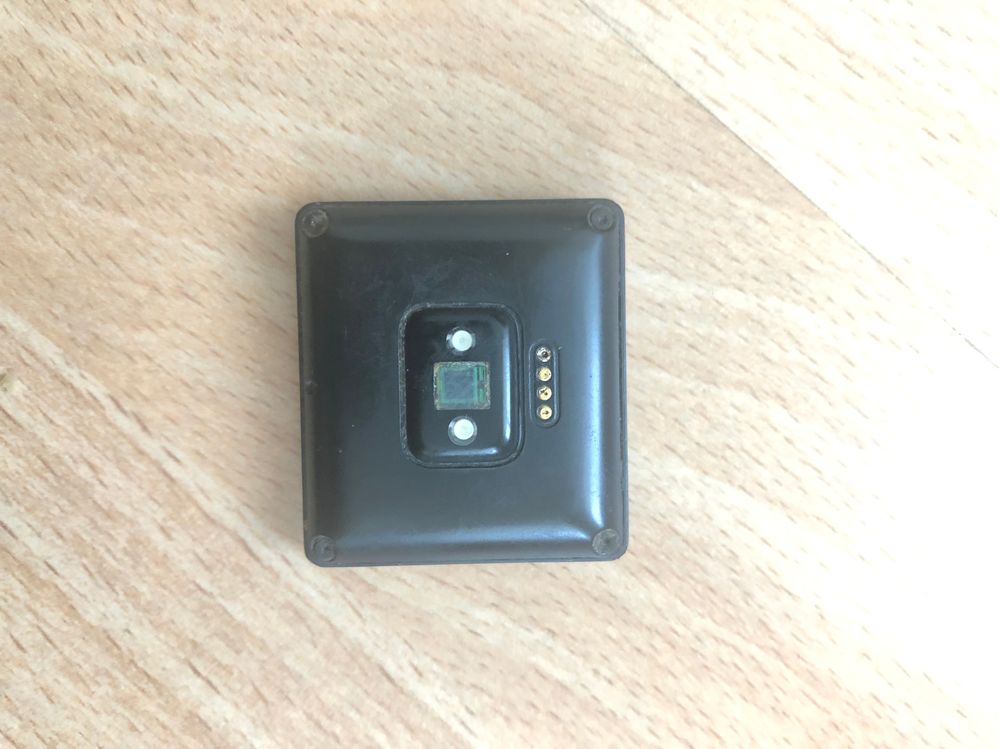

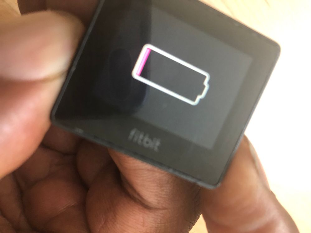

I have the same problem. After two years of hassle free use, my Blaze no longer charges. I’ve cleaned the contacts, changed charging outlets and used different chargers. I’ve left it on charge for more than 24 hours and even the reset hasn’t worked (it won’t let me reset again). I’ve read through the forums and checked the “why doesn’t my Fitbit Blaze charge?” link. I really miss it and obviously links to my Aria 2 scales.
I’ve included photos below.

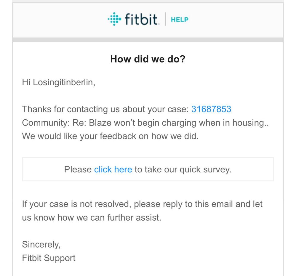

I have only received this (see attached screenshot)
I replied to this email today.

I appreciate the additional details and a screenshot of the email you received. Thank you for letting me know that you've replied to the email. I've confirmed that our Support team sent you another email, please check your inbox. Our Support team will do their best to help you, please keep working with them.

Looks like the corroding contacts are a common issue.  After a couple of years my Fitbit Blaze is now having significant issues charging as well.  In the past I was able to follow the cleaning procedure for the contacts and found that worked but now the contacts have corroded so far that the spring that is behind the contacts are showing and popping out.  Not sure the options here but disappointing as this is my third Fitbit and I'm tired of having to pay more for another one after 2 - 3 years of use.  Here a picture of the back of my Blaze, the second contact from the left is the one that has now corroded so far the spring is showing.
