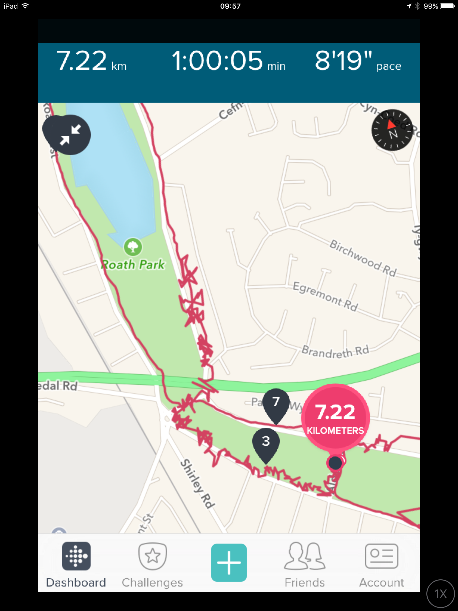

This is the GPS map from my run this morning. It's the third time that this has happened. I waited until I had all of the bars green when I connected my phone but it went crazy after the first KM and has got my pace and distance totally wrong which is really frustrating. Has anyone else experienced this and does anyone have a fix? I do love my blaze but accurate data while I'm running is something I really want
