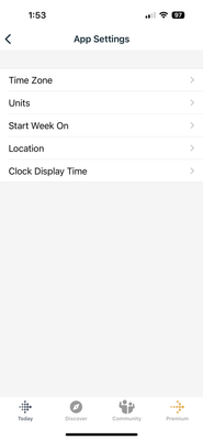

HI STEV
I had the same issue so what I did was two things and it works completely fine👍
1. Check the location in the fitbit app (you will find this in two tabs)
go to the APP
top left SETTINGS button
you will see APP SETTINGS (do locations that are allowed for ECG)
after that in the same page top you will find the profile there if u go change the location is possible) once done it should worl else return and take refund 😊
2. Unpair and restart
all done

did you try changing the location at the below?? One in tge below image and next one in the app settings - personal tab - location in the app???
Uninstall the app and dobthe same again if required. It will work
