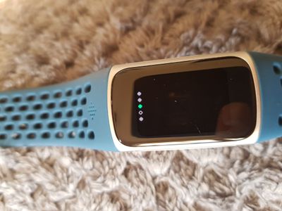

I have 5 dots towards the top of the screen that will not go away. I cannot navigate or double tap to remove. I have had the watch for less than one day.

Hi, welcome to the Fitbit Community forums, @CurlsinCO.
Thank you for all the details that you've provided regarding the problem that you've been experiencing with your Charge 5.
It seems that you already contacted the Customer Support team for further assistance with this and they've provided you with some instructions. Let me know if you continue to experience this inconvenience with a specific clock face and if you continue to see the dots on the display with this clock face after the restart procedure described here.
Please keep me posted.

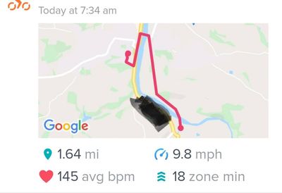

Best AnswerI've experienced the same issue this morning. Battery @ 78% After 34 mile cycling, I discover Charge 5 stopped after 1.64 miles.
I've just restarted and battery now showing 68%, so not a battery problem. All seems to be working now, but I'm obviously disappointed at having not recorded my 34 mile ride. Charge 3 was very reliable.
