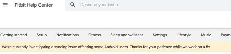

Hello @Tennis_pickle
There is a message on the Fitbit Support page acknowledging the issue for Android users, which may have appeared starting yesterday (28 Oct 2024). See below
So far, I haven't see a timeline for the fix. I expect that the message on the Support page will be removed when the issue has been fixed.
