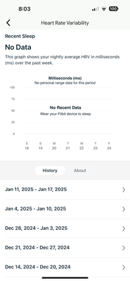

Hello,
When I look on the Fitbit app for my Heath metrics, it's saying "5 of 5 metrics available" (BR, SpO2, RHR, HRV, Skin temp variation).
Though, when I clic on "Health metric" then "Heart rate variability" it says "No Data". It makes 5 days I have the charge 6 but I have never been able to see this data.
I sleep more than 7 hours every time. Last time, I emptied the cache, restarted my tracker, redownloaded the app and re logged.
How come I'm still not able to see this metric? This is very annoying...
Thanks

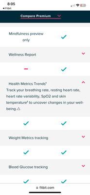

It’s my understanding you have 6 months premium free; then after that it’s a monthly or annual fee. Is this within your timeframe?
Same with the sleep mode, I get it!! I am sharing what works for me; I use to go into the Fitbit app each night and tell the app “ sleep now” it just didn’t work for me. I read through this thread to use the “ sleep mode “ each night, just remember to turn it off the next morning. It’s worked each & every single night for me without a hitch, everything has shown up for me; sleep scores, all stages, all 5 of the Health matrix, Readiness score, Stress Mgmt score.
The only thing I’ve notices is the readiness score takes longer to show up, I just keep syncing until it does: abt 30 minutes no longer.
I just went a read about the premium subscription- compared to free app; I’ll include the info.
Try Sleep Mode; see what happens. ?

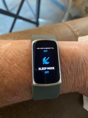

Yeah, I can’t edit workouts. & I knew stair steps weren’t a thing with the charge 6.
With notifications, within your iPhone make sure you ( on your iPhone ) allow all the apps you’d like to be notified from; ie weather, Forbes; whatever the case; and that your Bluetooth has not lost connection, ( roughly 30’ from your phone ) & make sure your DND is not on, also sleep mode being on stops notifications, Hr zones, etc all notices also.
The only syncing issues I’ve noticed is; Readiness score doesn’t show up immediately after syncing in the mornings ( sync my Fitbit watch to My iPhone ) it usually takes about 15 to 30 minutes.

Hi, I constantly get a no data message on my HRV on Fitbit. I have tried everything. Suggestions?
Thank you!
