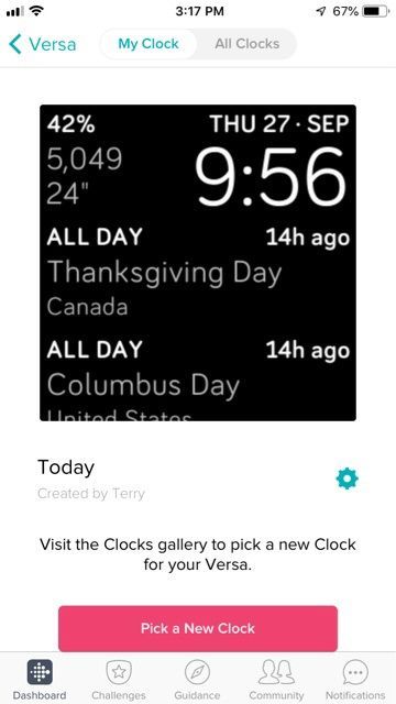

Step 1:
After installing the third-party "Today" watch face, your watch should look like this:

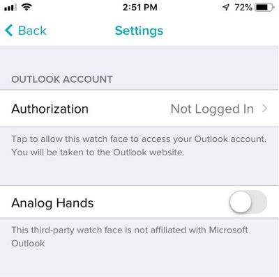

Step 2:
Now click the gear icon on your Fitbit phone app to enter Settings.

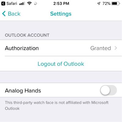

Step 3:
Click on "Authorization" to begin the login process:

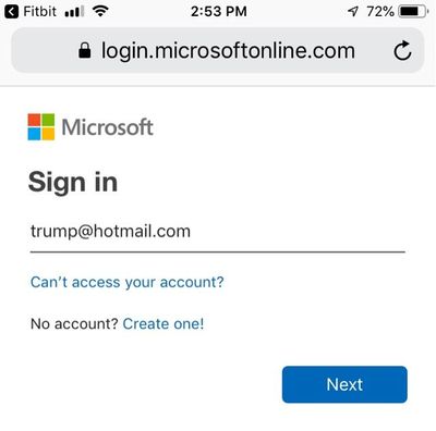

Step 4:
You will be taken to the Microsoft login webpage. Login with your Hotmail, Outlook or Office 360 credentials, then click "Next":

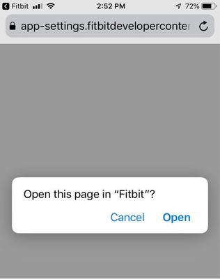

Step 5:
It will prompt you to open the Fitbit app again. Click "Open".

Step 7:
After a few seconds it should finish downloading and show this:

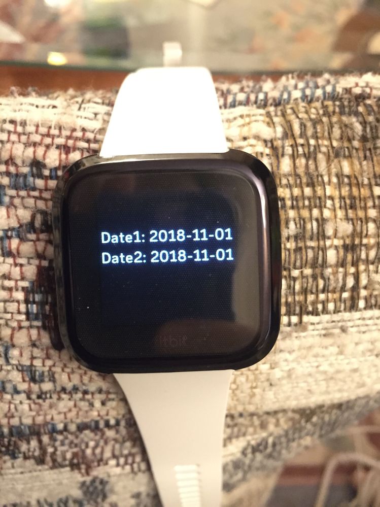

I've created a watch face that tries to display the month in the same way on Versa simulator, but according to https://community.fitbit.com/t5/SDK-Development/Localisation/m-p/2299579#M1503 versa only supports ES 5.1 JavaScript, and toLocaleDateString() doesn't support the formatting options in this version
Fitbit firmware version: 32.32.10.15 (OS 2.1.1)
For some reason fitbit studio sideload works only if you set 'SDK Version' to 1.0.
import clock from "clock";
import document from "document";
import { preferences } from "user-settings";
import * as util from "../common/utils";
// Update the clock every minute
clock.granularity = "minutes";
// Get a handle on the <text> element
const myLabelDate1 = document.getElementById("myLabelDate1");
const myLabelDate2 = document.getElementById("myLabelDate2");
// Update the <text> element every tick with the current time
clock.ontick = (evt) => {
  let date1 = new Date(Date.UTC(2018,10,1)).toLocaleDateString("en-US",{timeZone:"UTC",month:"short"});
  myLabelDate1.text = `Date1: ${date1}`;
  let date2 = new Date(2018,10,1).toLocaleDateString("en-US",{month:"short"});
  myLabelDate2.text = `Date2: ${date2}`;
Alright, problem has been solved by upgrading firmware to OS 2.2 (32.32.12.19)
