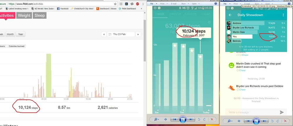

Thank you. Tried all that and it is all different. This time challenge shows 11037 instead of 12182 which is great, because it is closer to what the device said I had done. But the dashboard is 10124 instead of 11033? So now I have done less steps there than I actually did?
I also reset the device too.

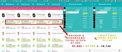

Just noticed my tracker steps and my Phone Dashboard steps match, but I'm in two challenges and my step total was off by 11,000 steps (Wed 02/22/17)? I thought it would eventually register, but nothing after 3 hrs? So I rebooted the tracker and uninstalled the phone app and reinstalled. Still no change? Today I thought things would change but they didn't? I had 15,699 steps on my tracker and dashboard. but only about 10k steps registered (Thur 02/23/17) in the two challenges?
Day          Tracker & Dashboard steps     Challenge step total    Actual Step Total        Delta
Mon         19269                                           19269                          19269                          0
Tues         15664                                           34933                          34933                         0
Wed         17468                                           41194                          52219*                         -11025
Thur          15666                                           51743                          67885*                        -16142
* Today and yesterdays numbers have only partially registered?
The same apps were on my phone when this problem started Monday - Wed. Today I uninstalled the "Pacer" phone app to see if that was the problem even though it was running and on my phone on Mon and Tue when the numbers registered correctly in challenge. Something is wrong and it isn't me or my phone! It's the tracker or the app!!!

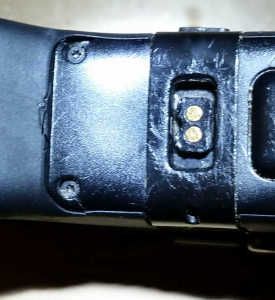

I found out that the back seal had been compromised.
There were fractures on the back where the screws were.
This allowed moisture from sweat and showers in and was causing the problem. See picture. I had to send in on warranty.
