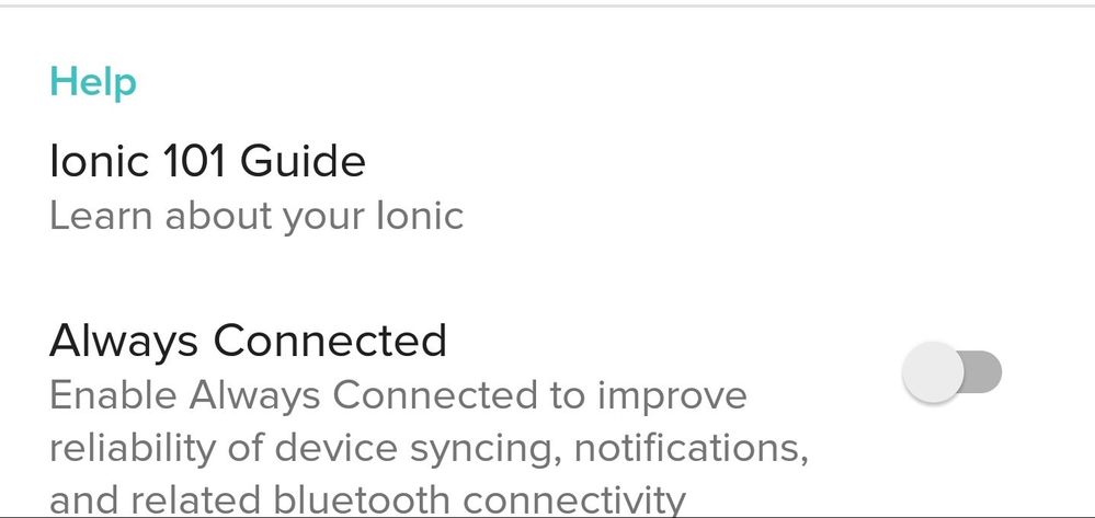

I had an issue with battery drain overnight. The fix that work for me was turning off all day sync and the Always Connected option right at the bottom of the Ionic settings in the app. See if that works.

I changed the all day sync off yesterday. Where is the always connected option?

Right at the bottom of the Ionic settings part of the app.

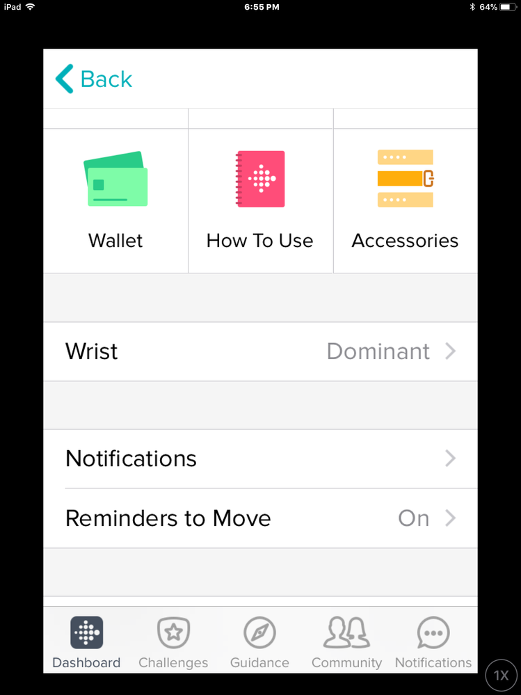

My app looks different, huh? Wonder why?
Best Answer10-18-2017 21:45
10-18-2017 21:45
Try restarting it and see if that improves it. If not, contact Support.
Helen | Western Australia
Best Answer10-18-2017 22:54
10-18-2017 22:54
Yours is the iOS app, the other one is the Android version. I don't believe the iOS version has the option for always connected.
