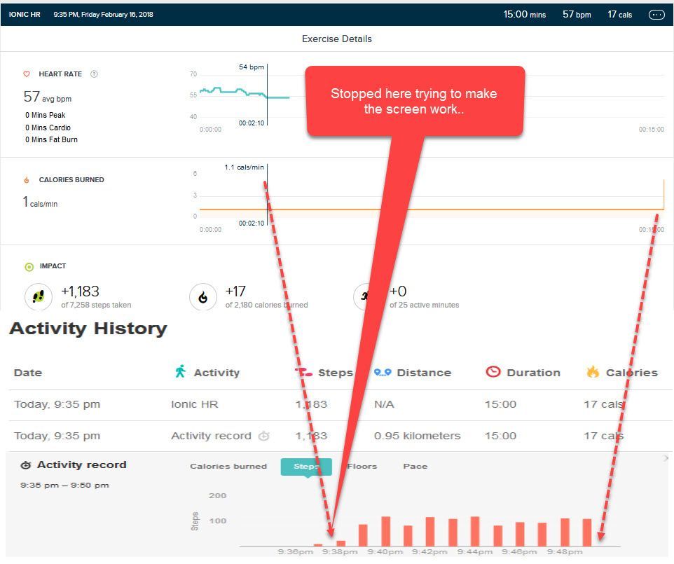

@SilviaFitbitAnother variation, of the blank screen and to my knowledge this has never happened to me before.  I'm posting this here so that I have a record..  My Ionic is from the first batch released in Australia a few months ago and other than the syncing issues etc virtually trouble free..
It has Firmware V27.31.1.29 - Updated in 9.5 minutes via 4G+ yesterday.
  • Ionic - Battery was @ 83% when I started

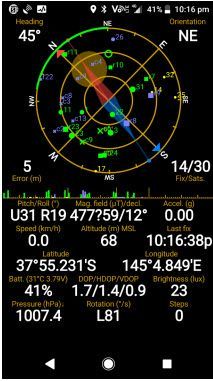

  • Started a walk exercise with GPS - did not wait for Connection because I'm having trouble connecting.  See last image of available satellites from App on phone at the same walking area a few minutes later.``
  • Just over 1 minute into the walk I tapped the screen to see how I was going..
  • Screen went blank, but the HR sensors were flashing and I couldn't activate the screen by button pushing.
  • Gave up at 15 minutes after returning home.
  • Screen still blank, HR still flashing
  • Put the Ionic on the charger and no sign of battery level, or that action switching the Ionic on which normally happens if you have a switched off Ionic and put the charge cable in.
  • At this stage I held the LH and RH buttons and the Ionic did a reset,,
  • There was no new activity for steps from my starting time on the Ionic screen but working
  • I synced the Ionic, it struggled, and I restarted the Bluetooth on the phone, that worked.
  • I then synced the Fitbit One (multi), 1,183 steps
  • Create my Ionic HR graph and the HR stopped at about 2 minutes. See image
  • The HR coincided with the low step count on the One.
  • The steps in the Graph are from the Fitbit One
  • The calories should have been about 50 for the speed I was walking, so the 17 calories came from the Ionic and I accept that can happen in the way I use multi mode. So that proved the Ionic was not recording.
  • So tomorrow I will try again and advise..
I thought the Ionic had switched off when I tapped the screen, but having the HR lights flashing made me think otherwise. Smiley Happy It just proved the way I use my Fitbits I didn't lose any steps..
Finally I did a short test, only 130m, same satellite activity and the Ionic connected at the 40m mark. With my connection issue I will always start walking because my step size is accurate and I find the final GPS walk, even if broken, is accurate.
