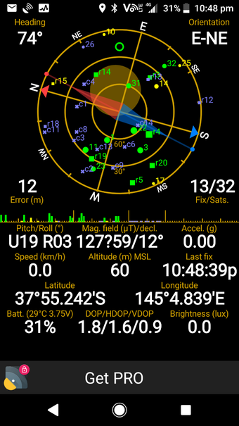

@RuthyhrooDid you have any positive answers from Fitbit Support. I ask because I had the same issue this evening. I have checked, double checked and followed what @SantiR suggested. My Ionic battery was 83% and I restarted the Ionic before I started and waited for a connection... It has worked before. It was just "Connecting" all of the time I was walking..
The image below is my available Satellites, clear sky, stars, no clouds, only single storey suburban houses and no overhanging trees and
no Lunar eclipse.. Just pavement walking.. The resulting distance was steps x my fixed stride length. I'm happy with that.

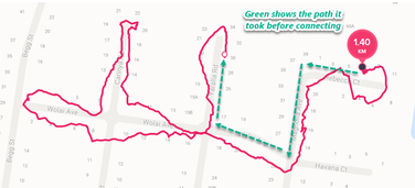

@DebBytesSame problem last night for me and didn't connect at all, and this was immediately after the latest firmware upgrade on the Ionic, not fixed.. Same number of Satellites.. No news yet, but it did connect the other night and this is what I received, I gave up waiting for it to connect so I started....The distance was correct, but the plotting erratic. The pace was accurate... and of course it used my step length for the missing distance at the start. I was walking so that wasn't an issue of varying step length.

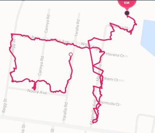

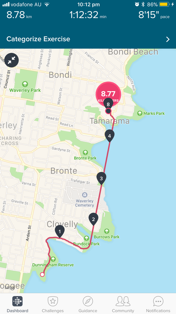

@Johno84I finally built up a case and emailed the results to Fitbit Support, and with some backwards and forwards dialogue with more results, suddenly an email to say a replacement was on the way.. Within 3 business days I had a replacement Ionic from overseas. They sent it on Thursday and I installed and updated on Monday.. Great service.. The original Ionic was 6 months old and degraded about a month ago..Seemed to coincide with the OS2 and Firmware upgrade but that may have just been the luck of the draw and a red herring...
This link explains to another user what I needed to do.. Fortunately I had a Surge as well.
I also made sure it was connecting for a sizable walk on all devices. The first image was just before the total failure and you can see how far I walked before it eventually connected and then the erratic tracking. The second image was the 13th February in the same areas.. and last image from last week is in the same area where I live, and crisp and clean.. with comparisons.. So the GPS was definitely faulty on my first Ionic. I backed all of the results with the GPS Status App.. shown in the link.
