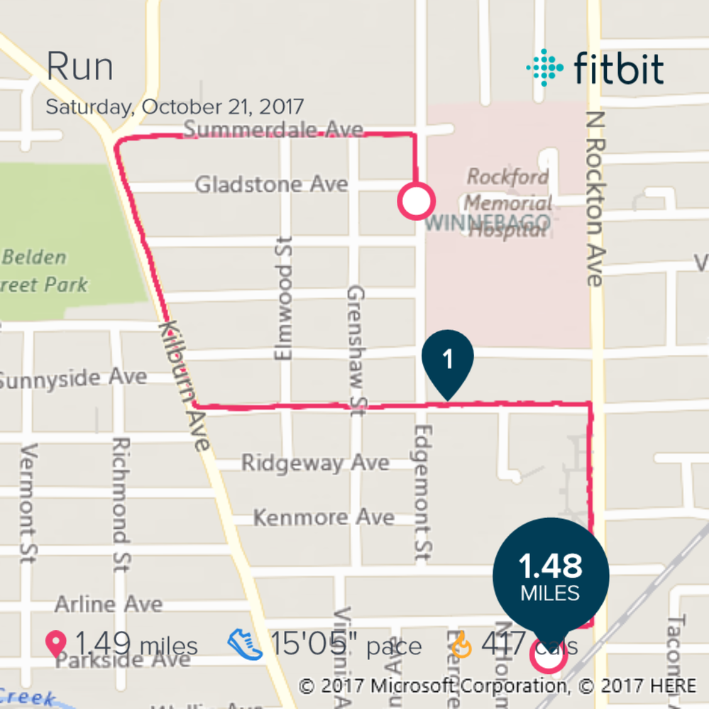

this just happened to me today also, on a 3 mile run lost first 1.5 miles saved all step data just lost run info, other info new ionic bought yesterday with latest firmware
