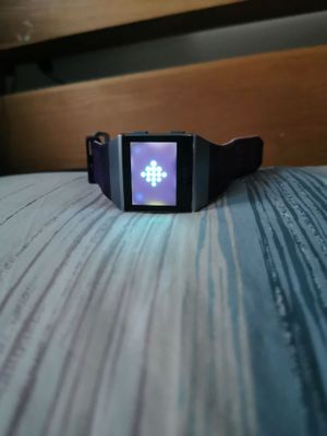

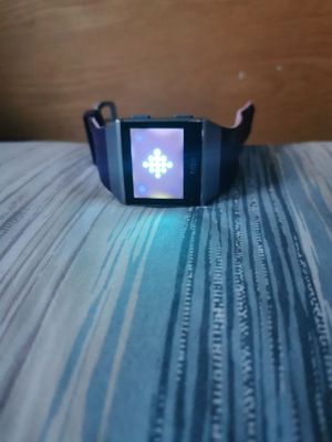

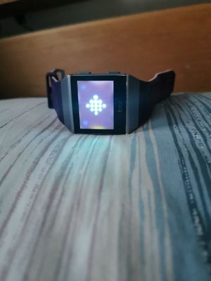

I love mine so much but this is all I get now flashing this every two mins I think its gone to fitbit heaven ...

this just flashes all the time. RIP Ionic....

all I get is this flashing over and over. Screen looks kaput though

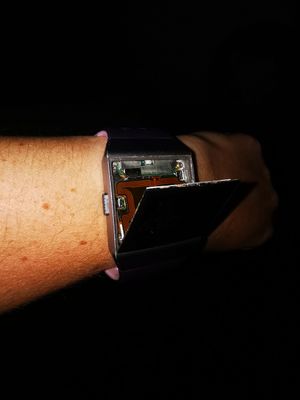

So mine after two days started working again... Then this happened.
the face just half fell off!
So I'm guessing the seal had gone and that's why mine went bust.. Two years seems to be the max really..
