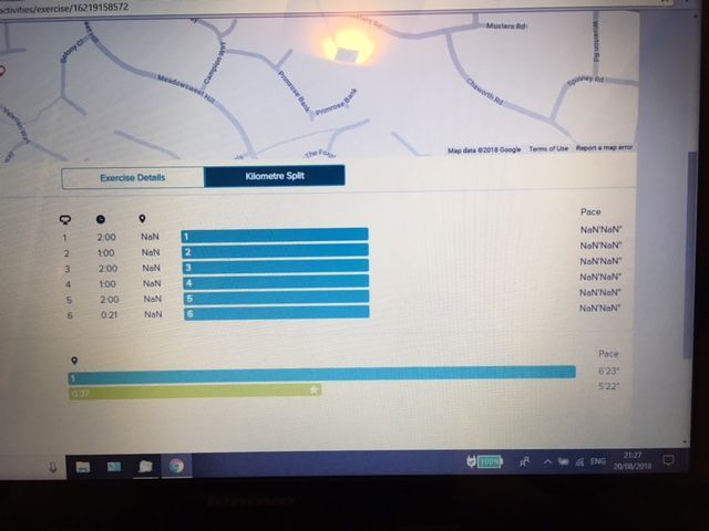

Thanks. Logged out on settings on laptop and no change.
Interval workout detail does not show on iphone. However I forced quit anyway and still no change on the detail in my account via the web.
Here is the screen shot.

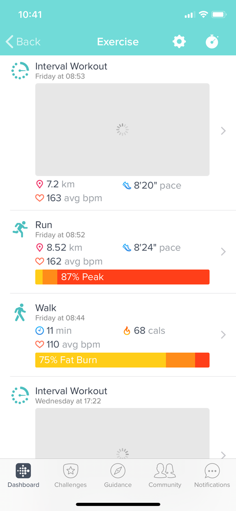

Did you get this resolved. I just started using interval exercise function with GPS on and the map does the same thing. Juat spinning circle in center and no map. I have used the running and biking exercise function with no problem, maps always work. Tried logging out and forced close. Still no map.

Hi - I am having the same experience as you are. When I use Run or Walk from the Exercise apps the map works fine. When I use “Interval training” with GPS On the area where the map would normally appear just spins just like your screenshot. Did you ever get your issue resolved?

Nope. Use interval gps a lot still but map never works on app iPhone. Does work on pc dashboard. Wish it did. Also wish splits worked on dashboard. The data is garbage for splits. I use the interval for run/walk training.
