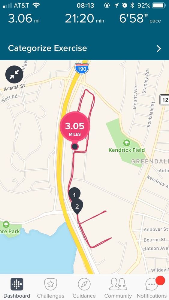

After months of totally Innaccurate stats, especially during road racing, my Ionic managed to perform well yesterday. Not perfectly, but well enough to be functional. At each of last fall's races Ionic understated distance by at least 33% and close to doubled my pace (both relative to official results in chip-measured races)
This is encouraging, hopefully GPS can stay connected beyond an hour and withstand long sleeves. If so, I might keep it.
Here are yesterday's stats:
