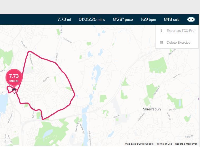

I've grappled with the loss of GPS connection (and other issues) since I got my Ionic back in October. Yes, you can download the data collected by the Ionic and I've found that sometimes it collects GPS coordinates throughout the run - even after Ionic indicates the GPS is trying to connect.
To get your data, go to the fitbit dashboard, open 'Activity History', 'View Details' of the run activity and then click the rightmost icon (three dots in an oval) above the map of the run (if you have one). It should look like this:
Export as TCX file
Once the file is exported, you can open it and search for the failure point. I did this several times last year. It convinced me that the Ionic's hardware is relatively sound; it's the software that seems to be the problem.
