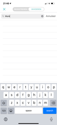

Hi
Unfortunately I’m still experiencing the same issue. It nust doesn’t find any kind of exercises...

@Joeypoey Thanks for getting back. I appreciate the screenshot attached.
It's pretty weird the display you're seeing when trying to log an activity. I noticed that your app is Dutch but the activity you're searching is in English. In this case, you'll need to search the activity in the same language that your app is.
As a side note, please confirm you're doing this procedure to manually log activities.
Let me know how the troubleshooting goes. I'll be around if you have any additional questions.
Best Answer07-19-2020 03:07

Hi,
Work-out is a Dutch expression as well and of course I tried all kind of entries Dutch and English. Just NOTHING shows. There is simply no database connection. I use Fitbit for several years now and in the past I didn't have this problem. I experience this problem since I have my Fitbit Charge 3. I hope you can fix this asap.

Hi.
I've got the same problem and cannot register exercise manually. I've followed the steps that you linked to, but no options for type of exercise turn up either in Swedish or English. I've seen more people on the forums with this problem but so far no solution.
Best Answer04-04-2021 11:19
04-04-2021 11:19
Hi,
I have a Charge 4 on firmware 1.100.34. Fitbit Android app version 3.40.1
I had the same issue since 3 days after updating the Android app to the latest. Had an empty list when searching an activity for manual input. Solved it by turning on "Automatic location" in the App settings. Before that "Select location" was set on Nederland (Engels).
So change your location to somewhere else in the App settings or turn Automatic location on. Hope it helps fellow users with same issue.

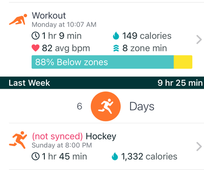

02-20-2022 06:38
02-20-2022 06:38
Hi There. I’ve done all that a few times. When I go back to the exercise a few hours later it says “not synced”
Best Answer02-20-2022 06:40
