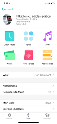

Does this help?

Yep. Sure does. I don't have the Adidas edition but it gives me hope when I contact them now:) 🙂
