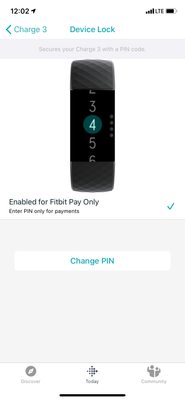

Hi, I have to Charge 3 and once I set my pin code I only had the option of enabling it for Fitbit Pay, not the recommended enabled option. How do I get that option?

Hi again,
I logged out of the app and forced quit it and followed the steps you provided, but after logging back in it still only shows the Fitbit Pay option. I changed my pin and that still didn’t work. I’ll attach an image:

@brandonmoves Thanks for the screenshot shared. Since you have a Charge 3, the only option you will have is enabled for Fitbit Pay, the other option is for watches. You can learn more about it by checking the Product Manual.
