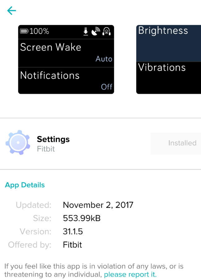

Hello, anyone else having this problem with their Ionic where the Screen Wake setting is missing? I noticed something was wrong when my watch suddenly stopped waking when I turned my wrist up to look at the time. I went into settings and the screen wake setting was gone. I also soft reset the device and still no fix. Your help would be greatly appreciated hoping not to have to hard reset.

Disregard looking in the "Settings" App itself. You have to swipe right from the home screen to get to the "Screen Wake" setting. I was confused since the Settings App Details displayed as if the "Screen Wake" setting was in the Settings app itself. (See attached picture below on why I was misled) Anyhow, somehow my watch switched to manual setting for "Screen Wake" and I don't know why. Once I switched it to auto it worked as before.

Mine did the same thing. Swiping right I found it set to manual. Misleading instructions on pictures from Fitbit for sure

With the new OS if you have it INSTALLED.. HOLD DOWN THE LEFT BUTTON For 2 Seconds, it will appear then set it to "AUTO"

Hold the left button down and it will pop up, it chAnged with the update
