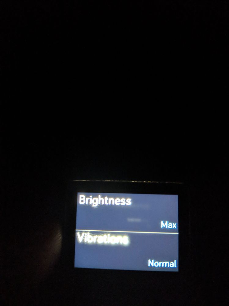

Screen and bezel do not align. There is a considerable gap between the bezel and the screen which some here have suggested may affect the waterproof quality of the watch. Two of my three friends who have bought the watch have returned them due to water damage. They believe that this is due to this misalignment. From what I have seen both in this community and in person, many Ionics suffer from this issue including the demonstration models at the stores.  Other problems have included an inability to connect to the Wi-Fi, or not having the Wallet tile available at all.
Luckily, Fitbit support got into contact with me and have asked that I exchange the product. I have now returned the watch and await for another one. I highly recommend that you test your Ionic. Maximize your brightness setting and simply enter a very dark area. It is important to manually maximize your brightness as the auto sensor will automatically set it to dim. Should you see light escaping the bezel as per the photos, then I would recommend that you contact Fitbit support immediately.

that post is still erroneously conflating two separate issues, light bleed, a common issue with lcd screens and thus not a defect, and frame separation an uncommon issue which is a defect. in short if you have light bleed, it's normal, there is not an issue with your unit. if you have frame separation, get a replacement.
@mitwess the light is bleeding from the gap in-between the bezle and the screen. It's not standard LCD light bleeding. This what everyone is talking about here. You can see in the photos the light bleeding is coming from the frame seperation. Mine has is it aswell. If light is coming through there then there is a good chance that water and dirt can get in there
So Fitbit support have replied and asked me to send back for a replacement I did ask for the replacement to be checked for any issue's before they send to me they said > "I'm confident you shouldn't* have any further issue with the replacement Ionic" So fingers crossed I will update the community when I receive!
@RiseAgainst i don't agree with your thesis. light bleed always shows up on the edges of the glass in most lcd screens. so the idea that light bleed at the screen edge equals a separation is erroneous in my opinion.
I had a light bleed at the edge where the separation was, I agree if there is no separation of screen and body you don't have a problem but most the time the two go together.
@mitwess light bleeding on LCDs is when the light on the LCD is bleeding on to the screen. Google light bleeding and you will see a lot of phones and TVs have light bleeding issues when on a dark screen. This is a completely different issue we are talking about here. The light is coming out of the gap in-between the bezel and and the glass so is a big issue since there is most likely not a water proof seal there
This is my ionic and the light isn't bleeding into the screen. The light is coming through a gap between the screen and the bezel. This isn't normal for any LCD product
Yes I understand what your saying not LCD screen bleeding but screen alignment not fitting issues.. Can you see the gap without turning the lights off?
